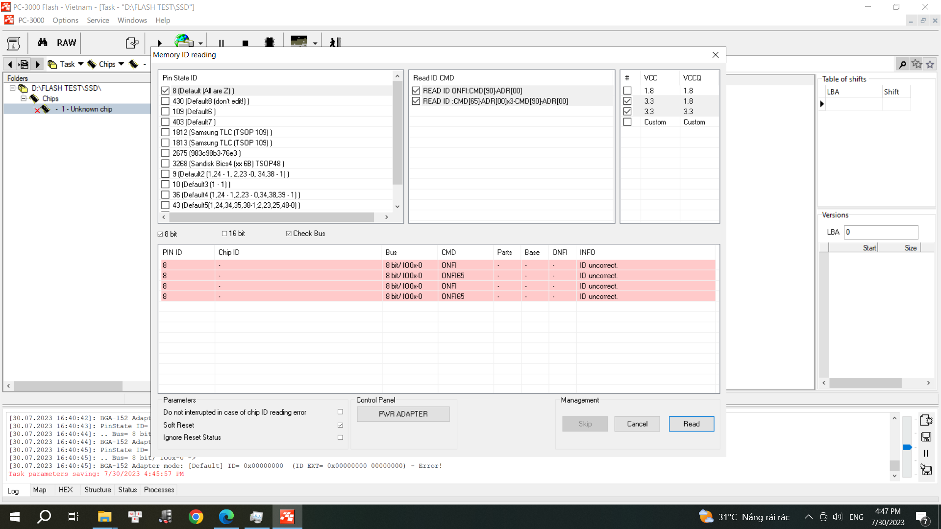

Hey Roman! Should the chips be automatically ID in the PC3000 Flash. Just wanted to get the dumps out
Re: WD Green SSD 20-82-00469-2 (SM2258XT) Short pins
There is no ID at all in your case. Chips are not reading. I recommend you to clean the bottom side of the NAND and try again.
