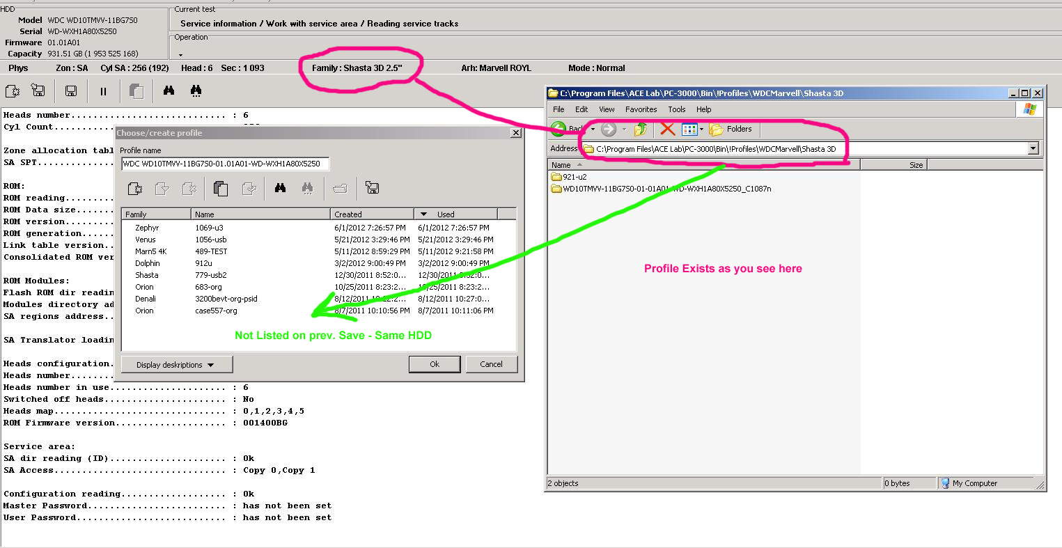

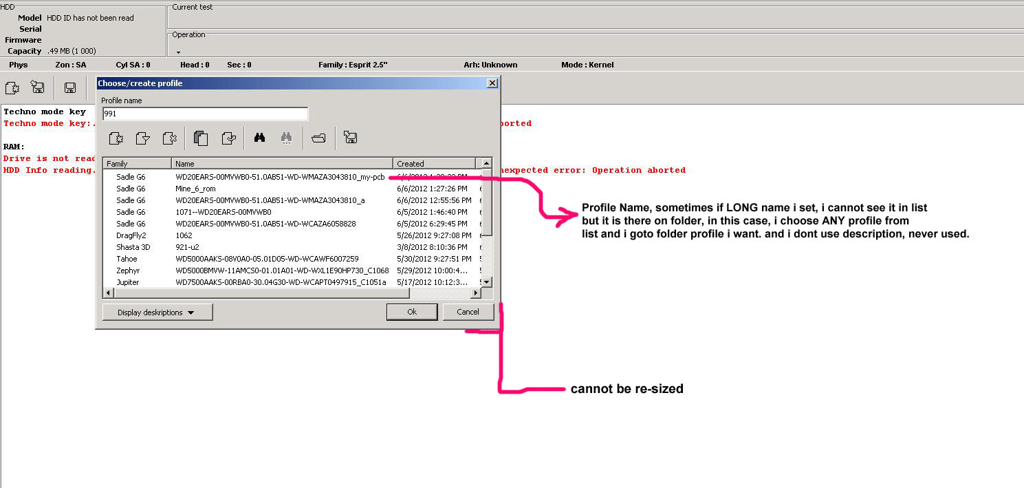

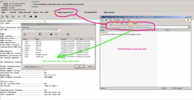

2- in Utility, i would recommend checking length of hdd model detected specially WD, i always add my Ref. Case # at the end of detected model, and when i do so, next time i open utility and FW resources are there it will NOT show it in Profiles i made if length is long. verify this in your side also.

2. Please show here example of how it should look, with some pictures.

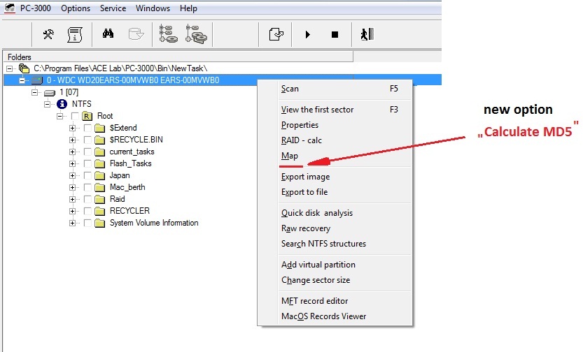

To pcrecovery:
This is how we see possible MD5 hash implementation in PC-3000:
Data:
defective drive-patient
prepared drive-donor for imaging
Tasks:
image data from drive-patient to drive-donor (sector by sector copy)
calculate MD5 hashes of patient and donor drives, check its identity
Algorithm:
1. drive-patient is connected to one of ATA ports of PC-3000 and is source of data
2. drive-donor is connected to another ATA port of PC-3000 and is destination of data (drive-recipient)
3. create new “make data copy” task in DE
4. launch the copying process
5. when copying process is finished the MD5 hash of drive-patient is calculated and displayed in LOG (“calculate MD5 hash” option would be also available in context menu of disk in explorer mode of DE, see picture)
6. create new task in standard explorer mode, source device is drive-donor that is copy of drive-patient
7. launch MD5 hash calculation in context menu of drive (see picture), result will be displayed in LOG
8. compare hashes of drive-patient and drive-donor
Would this be enough and convenient for forensic purposes?
Any comments and additions are appreciated.

here you go image attached.
last night i got a very nice option really for DE but i forgot what was it, am trying to refresh my memory and will post it here again
thnx for the fast reply Sheremetov

As i explained before about the problem with images
I see its the same on v5 now
As i mentioned before, i sometimes use LONG profile name, on attached image here you will notice that the Profile is ALREADY there on Family folder
but NOT LISTED in UDMA profiles.
i took screenshot image to show you this, i had it before but never made one, now you have it and you can see it
thank you
