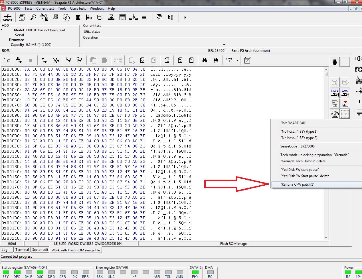

do this update can solve terminal lock in grenada 4 tb?

so sorry i mean ST5000DM000-1FK178 with terminal output like this

Seagate F3
Added correction to avoid hangup of hybrid drives Kahuna family in case of NAND damage (for CFW ROM);
I try. But it not work.
seagate sshd.jpg (486.4 KiB) Viewed 21983 times
Re: The newest versions of PC-3000 Express/UDMA-E/Portable are available now
Postby Amarbir[CDR-Labs] » 05.06.17, 08:23
cuumaytinh wrote:Source of the post Seagate F3
Why Not Create a New Thread Here -> viewforum.php?f=154 .I am also interested to find out if it indeed does work
