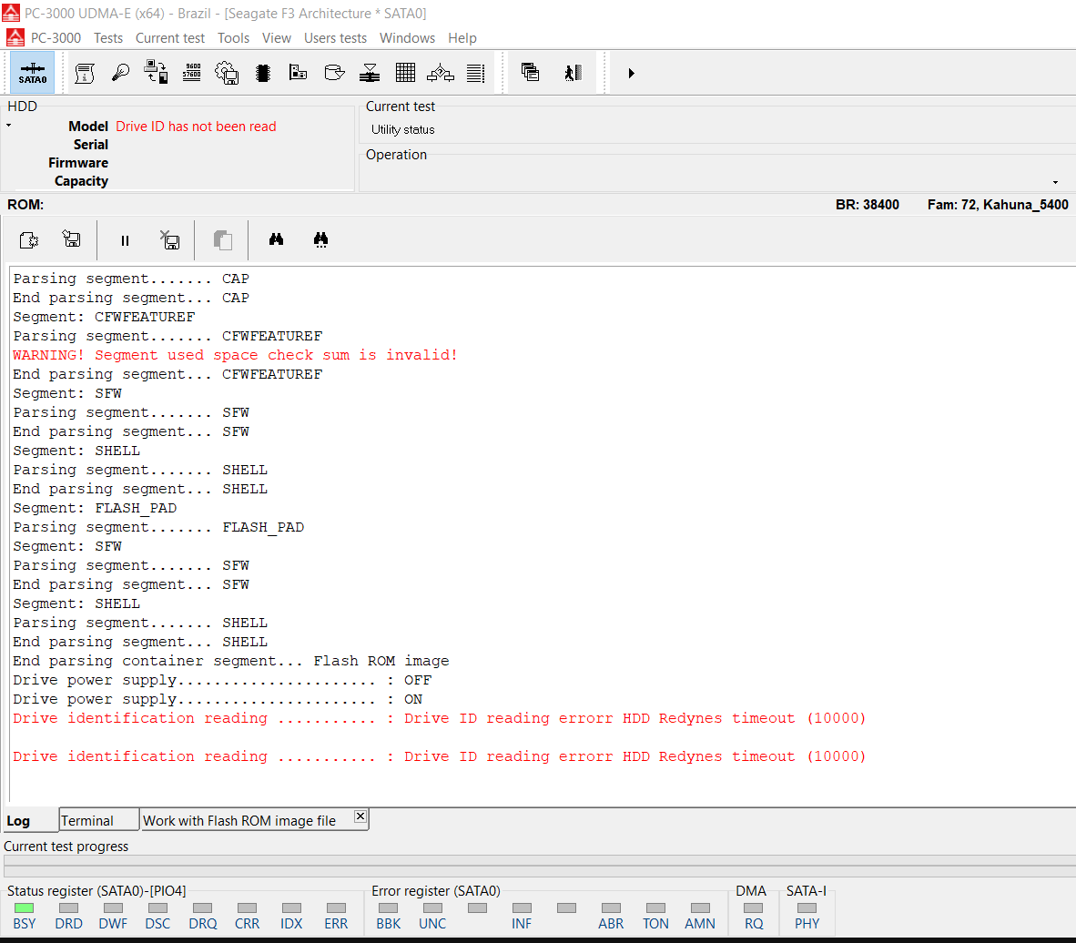

hello everyone
i have the same case
at first it was status busy and after a while changed to ready, but after i follow the topic atached here by kahuna 5400 utility, i wrote the rom and it's worsed, and now it's don't spins up anymore
i have a donor drive, i replaced the heads, my pacient heads were good because my donor runs with them normaly, but now i can't returns to initial mode because this model have a nand chip, and i don't know if i must replace pcb , it won't help without the original NAND , i think so
how do i make to returns to the first state ?
i wrote the original ROM after and it also didn't work, i think that i had a unique chance , and i wasted it
pc utility kahuna.png (23.51 KiB) Viewed 5321 times

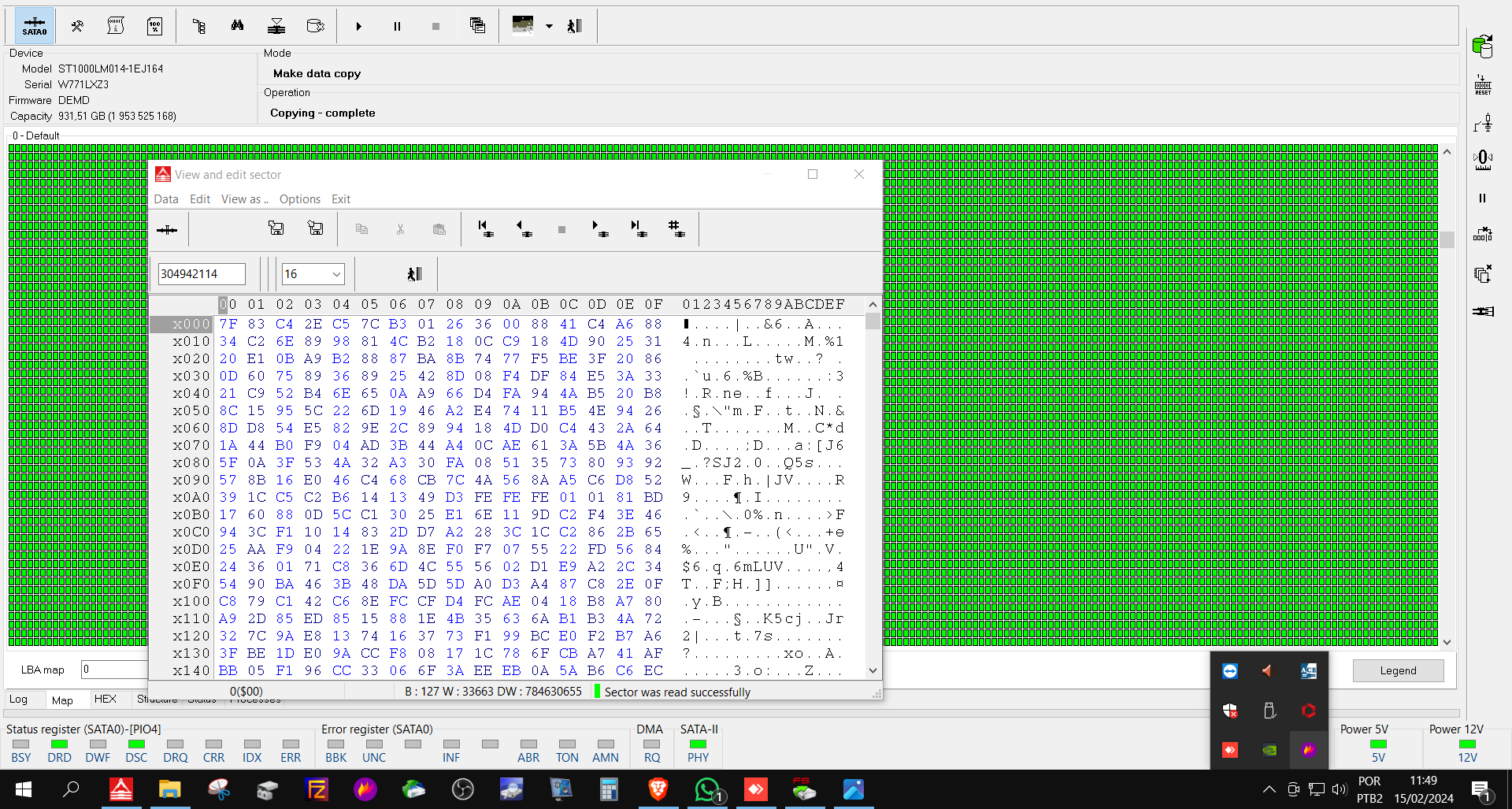

after i replaced the PCB , quick data analise on pc3000, NTFS, it's worked normaly, i restore client data without none problem with nand, the nand doesn't scare me anymore
SOLVED
kahuna replaced pcb.png (111.65 KiB) Viewed 5217 times
