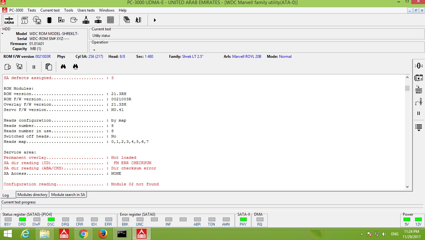

hi to all
i have a hdd WD 2.5 family shrek LT
this h.d.d no id
i have change pcb and convert to sata
i do "Uploder dir into hdd ram" but error :
Module (0001) read error Module ID 01 reading error Data request error - Device Error Detected: "FM ERR CHECKSUM"
i do manully uploder LDR from hdd same(rom VER)
loder is ok
test head is ok

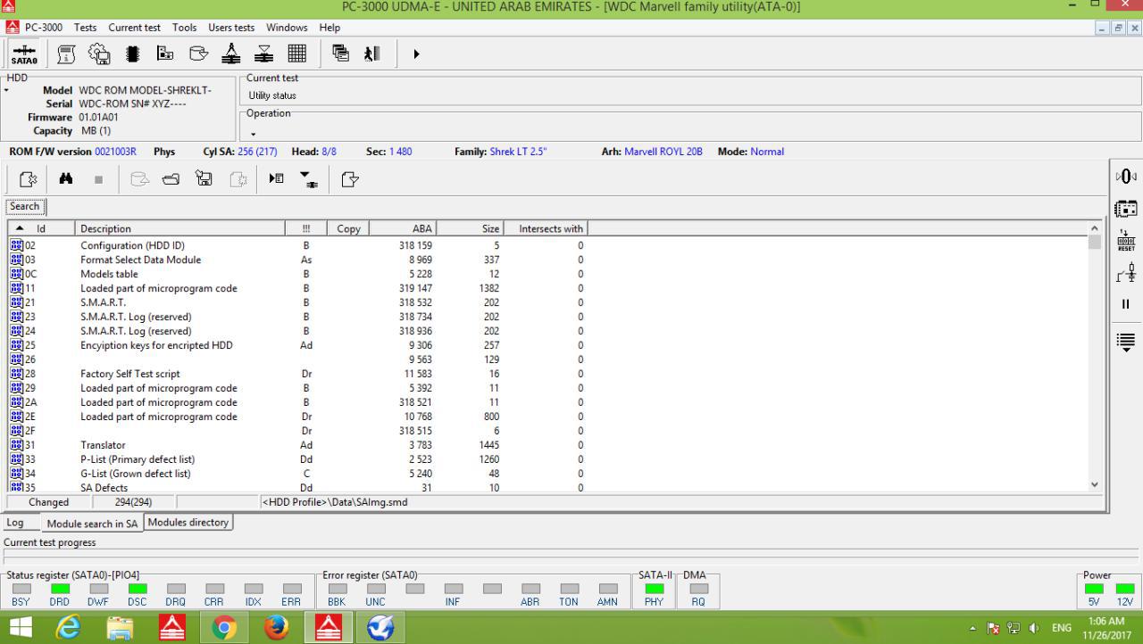

i do serch module in SA (by ID & by ABA) but not module 01,32,...
please help me
thanks :?
Re: not find module 01
Postby DataMedics » 29.11.17, 21:30
Did you check both copies? I think some Shrek drives actually have 4 copies of SA, so there's a good chance you can find 01 in there somewhere.
Also, am I to assume you transferred the ROM code to the SATA PCB? If you're using non-native ROM it may be reading the wrong SA region address, which would explain why 01 is missing.
Postby sepid » 30.11.17, 07:26
Thank you datamedic
Yes, I checked every 2 and
i do transferred the ROM code to the SATA PCB

Postby DataMedics » 11.12.17, 20:27
If you blocked SA access in ROM, and are then doing module search in SA it might not be properly accounting for the shifted region. Usually this is resolved by just closing and re-opening the utility. That, or you can backup the tracks and then do the search from within the tracks. Or, you can even just directly read the ABA region that the ROM specifies the dir module to be saved. Perhaps between the two copies you can piece together a good copy.
Postby Maxim_TS » 14.12.17, 16:49
Dear Amarbir[CDR-Labs], with all respect, you've been told to set the checkbox "Search nested modules" and tell about the result, but you answered that you were busy and going to do it later.
I still didn't get the answer in ticket nor at forum. Maybe I missed it? If you have the troubles with something, you are always welcome to contact TS directly with any bugs, we will do the best to solve any issues.
Amarbir[CDR-Labs] wrote:Source of the post I had done countless drives like this
Countless Giant drives? Or old Marvells like Sadle G6 or Mariner? Here in TS we are facing new WD drives with new issues every day, and, you know, actually the new drives are a bit different in their FW than the old ones ;)
sepid, check the dir address in SA regions editor, try to load the donor Dir into RAM from same model and FW backup, then restart the utility and check whether the Dir is readable or not in modules table.
It would be better if you contact TS with teamviewer details.
