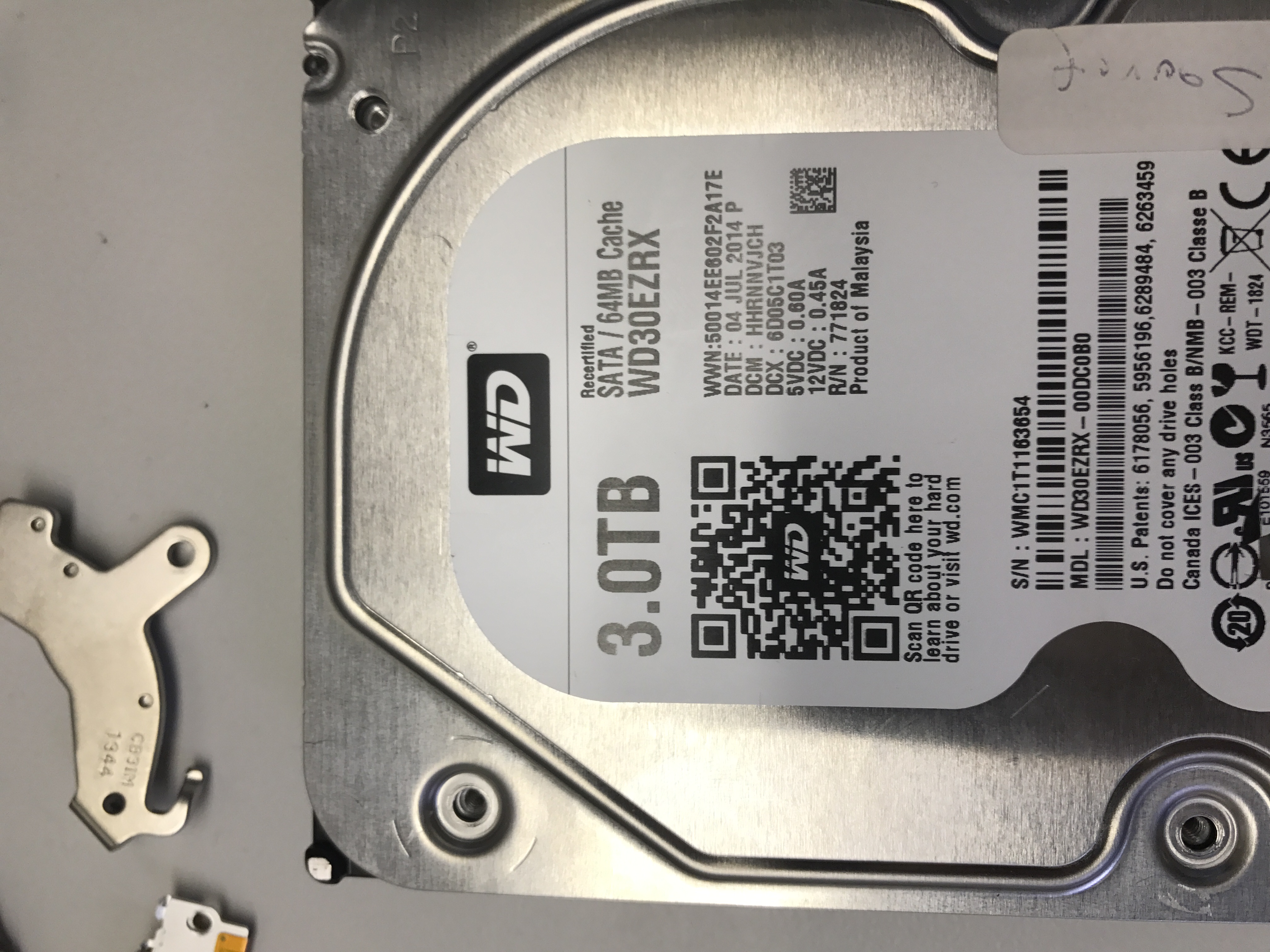

Post a picture of your drive and perhaps we can help you match it.

DataMedics wrote:Source of the post Post a picture of your drive and perhaps we can help you match it.
Let me repeat myself.
osity wrote:Source of the post I'm simply trying to match VJ in any 3TB drive.
You can't use just "any 3Tb drive" it must be of the same family. If you'd just post a picture I'd bet I can find you a donor in 5 minutes flat.

Sorry didn't have my phone yesterday. Here's the pic. I found a donor yesterday but it was hundreds of dollars. I'm looking for a better lower cost option.
Here's the picture.

Postby DataMedics » 13.12.17, 18:35
Some other Diablo 3D drives include:
WD30EFRX-68AX9N0 (or any other AX9 code)
WD30EURS-63SPKY0 (or any other SPK code)
WD 30EZRX-00DC0B0 (or any other DC0B0)
And, while I've never yet tried it, I suspect that Diablo 3S family may be cross-compatible. The ariel density is slightly different, but close enough they might use the same heads.
