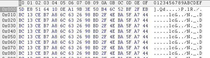

This is what i get for the last few sectors of the drive using either JMS and SED decryption.
Both seem like meaningless repeating patterns...

Those are likely sectors with no data, filled with zeroes. You need to find a sector that has data (preferably one with known data), to figure it out.

SED is not always the correct choice. Last time I had an option of JM and SED, it was JM. The way to test is try one, read first sector, check data. If shows 55AA, it's good. If it contains a mess of data, it's still encrypted. In that case, you need to exit the task and start over with a new one, choosing correct decryption option (ACE: it would be nice if we had the option to re-select a different decryption option after initial selection).
