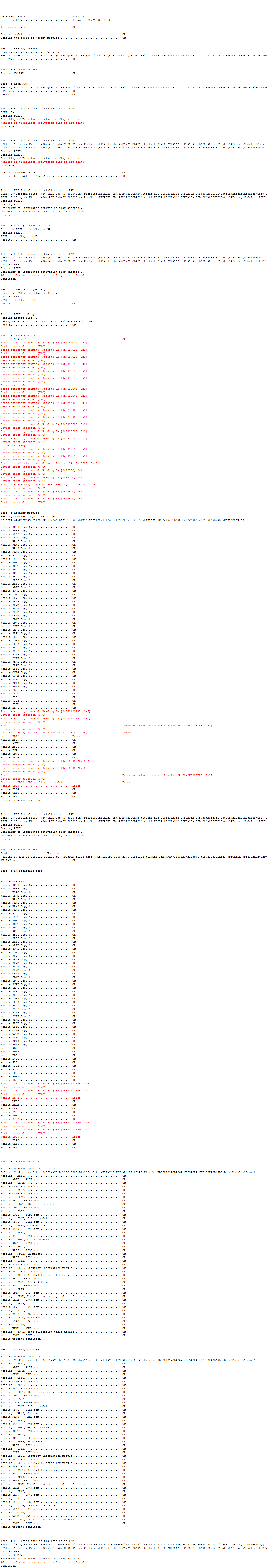

anyone know this " Address of translator activation flag is not found! " ?
i capture terminal log in below here :
Thanks :D ,
Jinarto

Most probably one of the Head is Damaged. I think this model have 2 heads. So you just try to make task in DE and Add " HDD Translator Initialization in RAM " in Active Utility Action. Then create the Head map and disable the head 1 and try to read the sector other wise head 0 . I think you can read the sector . Try and post here the result
