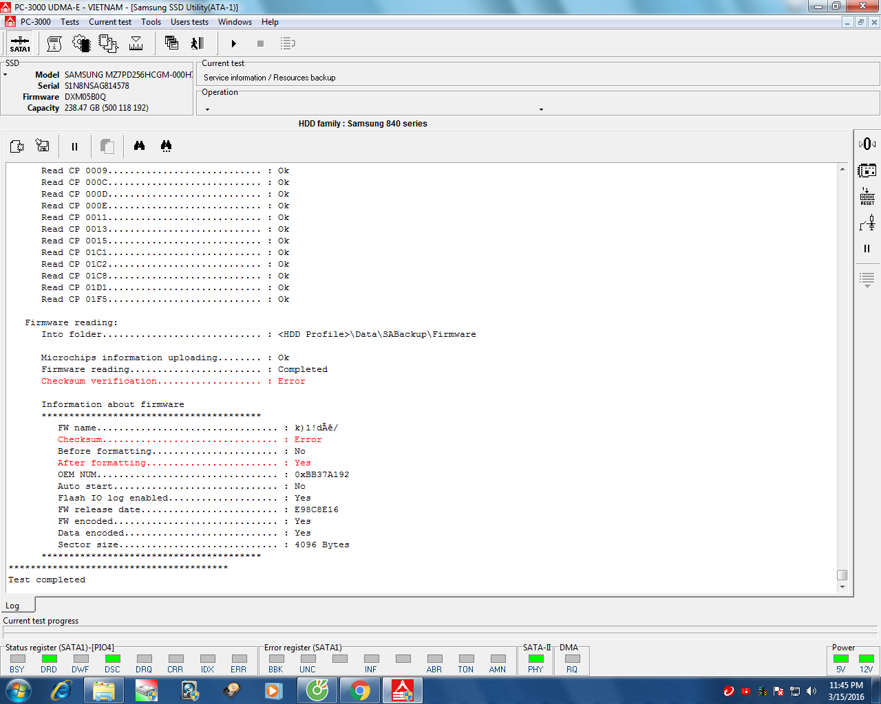

HI, I am have ssd samsung 840 pro, firmware DXM06H6Q, I want backup firmware, but all way checksum error

As I know we already have this FW in our DB - no need to make back up of it - you can use resources in updatebox, download necessary FW and write in on drive if you want. DXM06 should be there
