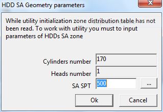

This disk isn't recognized.
As you can see, I don't know why, there isn't any module 11...
I change heads, same problem.
Do you have an idea ?

Hi Igor,
I have an other PINNACLE (PATA) with a similar problem (WD1600AAJB-00J3A0)
HDD seems to initialize, DRD-DSC but no ID (it doesn't spin down), Utility can find SA SPT, and I can search module. I can find Dir but still no Module 11. Again I see that modules are good until an adress, then they all broken.
This drive has one physical head only.
Do you know what should I do ? I have no similar drive now, I ordered one WD1600AAJB-00J3A0 but customer is hurried if you have an idea...

Re: WD3200AAJS-65B4A0 not recognized
I haven't any loader.
At first launch SA SPT is requested :
Then I have this :
