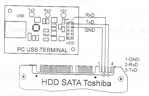

Drive stays busy, although actuator calibrates and settles. Have confirmed that the actuator is good. I suspect possible corrupt Glist, but drive not supported by PC3000. Can anyone help with possible terminal access to overcome problem.

Have you tried to work with this drive via 63GSX family? Or "Other SATA"?
Terminal should be connected like on attached picture.
