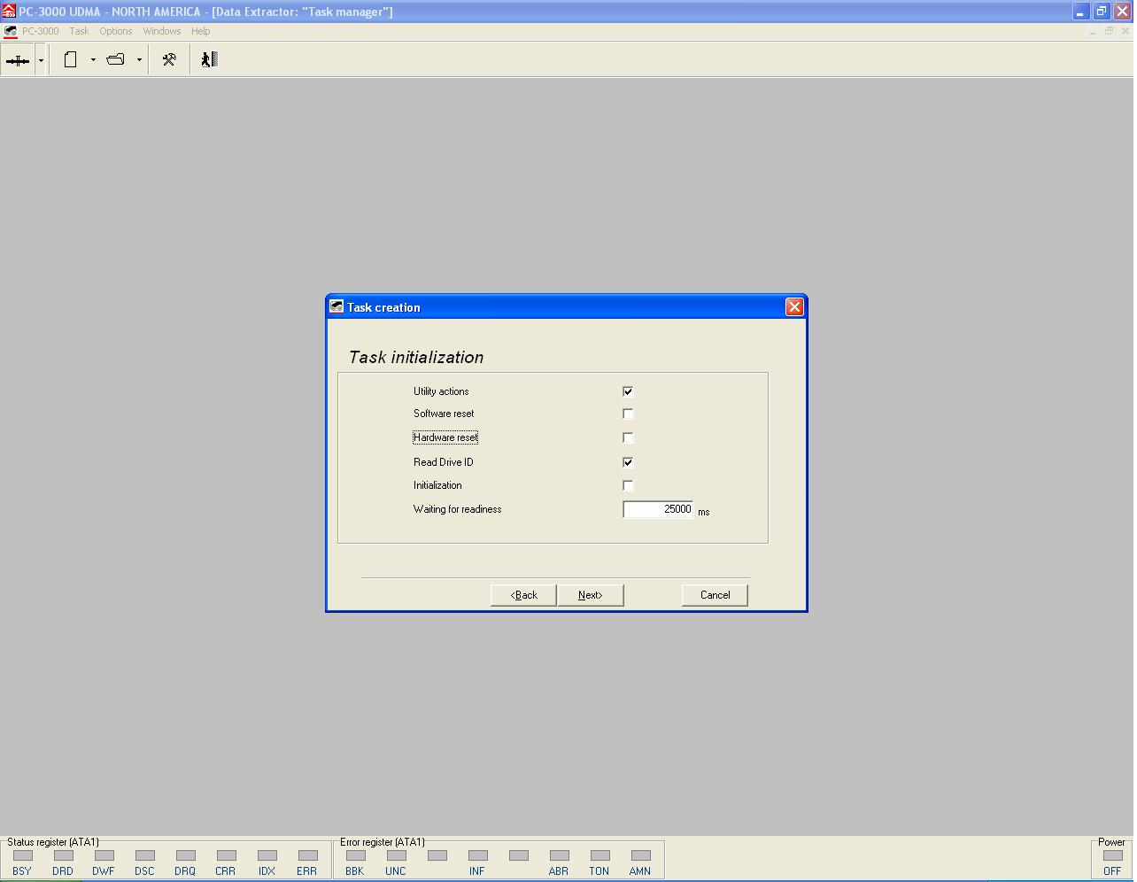

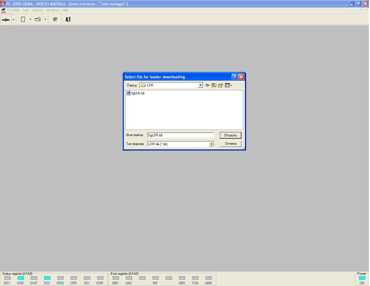

You should create loader with next options
Then run DE with next options
Choose HDD initialization and APP modifications for ATA
Then select loader saved before
And try to make an image.

Thanks Igor...I had same problem....it is great
Re: Seagate barracuda Antipending solution
I had the problem below and it solved it, is a good solution
Thanks Igor.

I think "fine until the end" is referring to the actual loading of LDR during task creation...
AJ2008 wrote:labtech wrote:If you create a new test task and attempt a new image of the source drive, does the image process still go well like you said until the end?
I suspect not.
I guess you are right.
Need to read loader from a file and not from the drive. Hopefully that will work.
