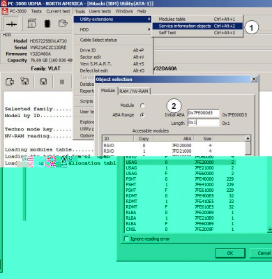

Sometimes it is happened, the board on hitachi-ibm drive dies completely with all its chips incluting ROM and NV-Ram chips. In this case it helps to find board with compartible ROM version and find NV-Ram on a surface.
Here are the settings to find it on HTS541040G9AT00
Use the "7FE000d5" address from my picture for all hts5410g9
Dont forget to turn off autoreassign before reading the data.

What about HTC426040G9AT00? Is it also possible?

How about if HTS541616J9SA00 NVRAM corrupted? Could the same methods be used? At which address?

What if the drive readies up but cannot ID. How can you find NVRAM on Surface???
