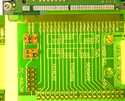

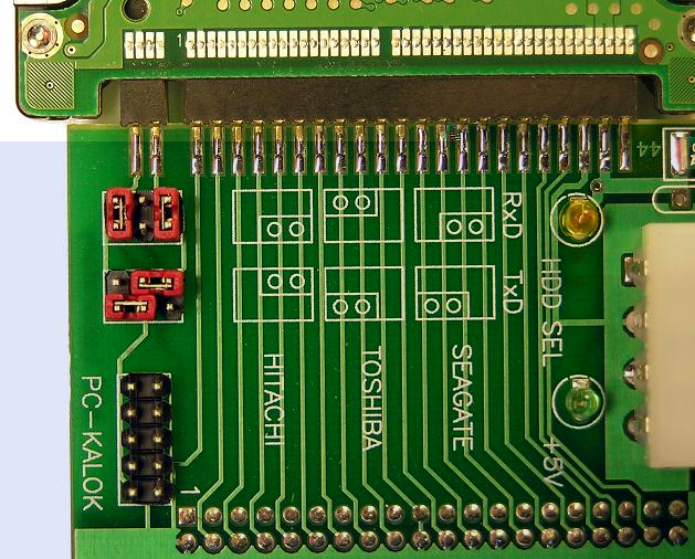

This instruction describes how to set the WD drives to Kernel mode.
To set the 2.5" WD SATA to Kernel you just need to unscrew PCB and connect it to PC-3000 PATA-SATA adapter without HDA.
WD 2.5" PATA drives

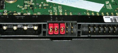

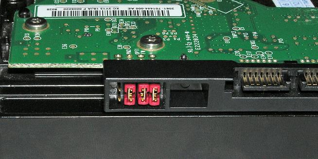

WD 3.5" SATA drives

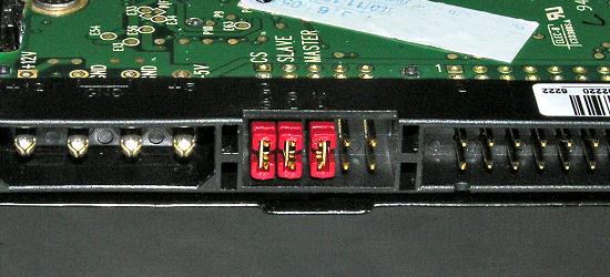

WD 3.5" PATA drives
