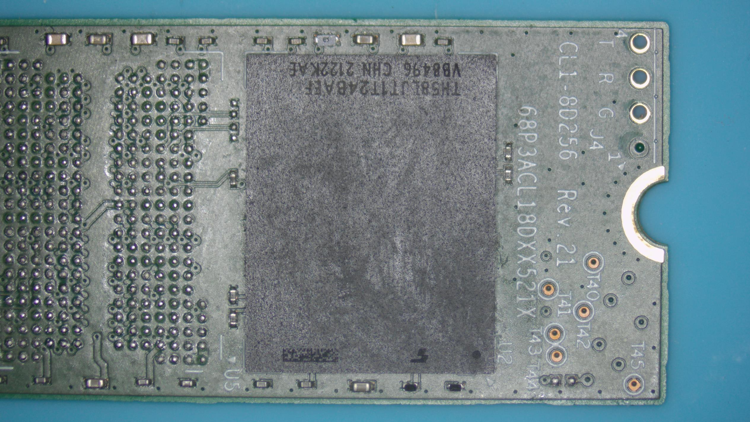

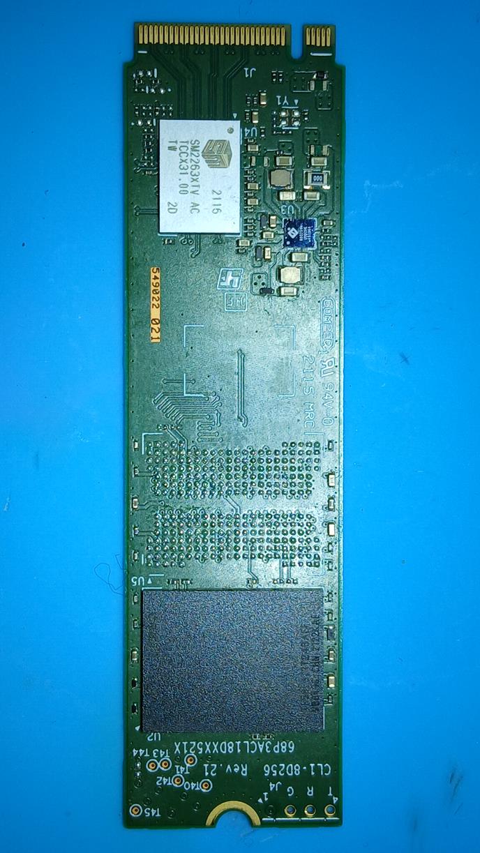

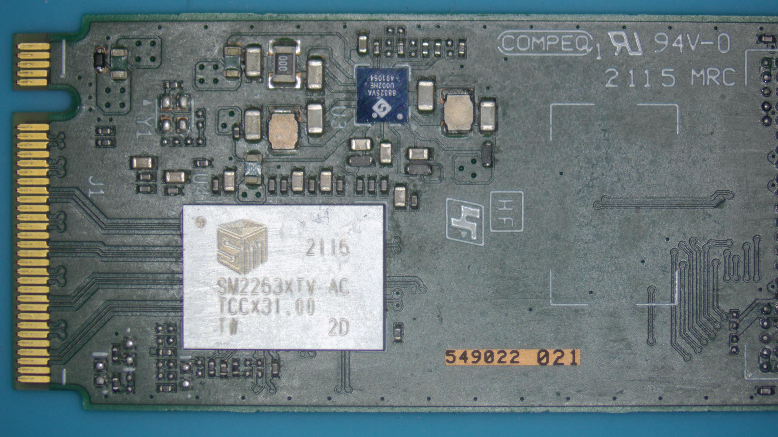

Does anyone know where the safe mode point is?
Image IMG_00 shows the entire SSD.
Images IMG_01 and IMG_02 show more details.

Safe Mode pins must be between T R and G points. Try T+R, or R+G or T+G combinations
