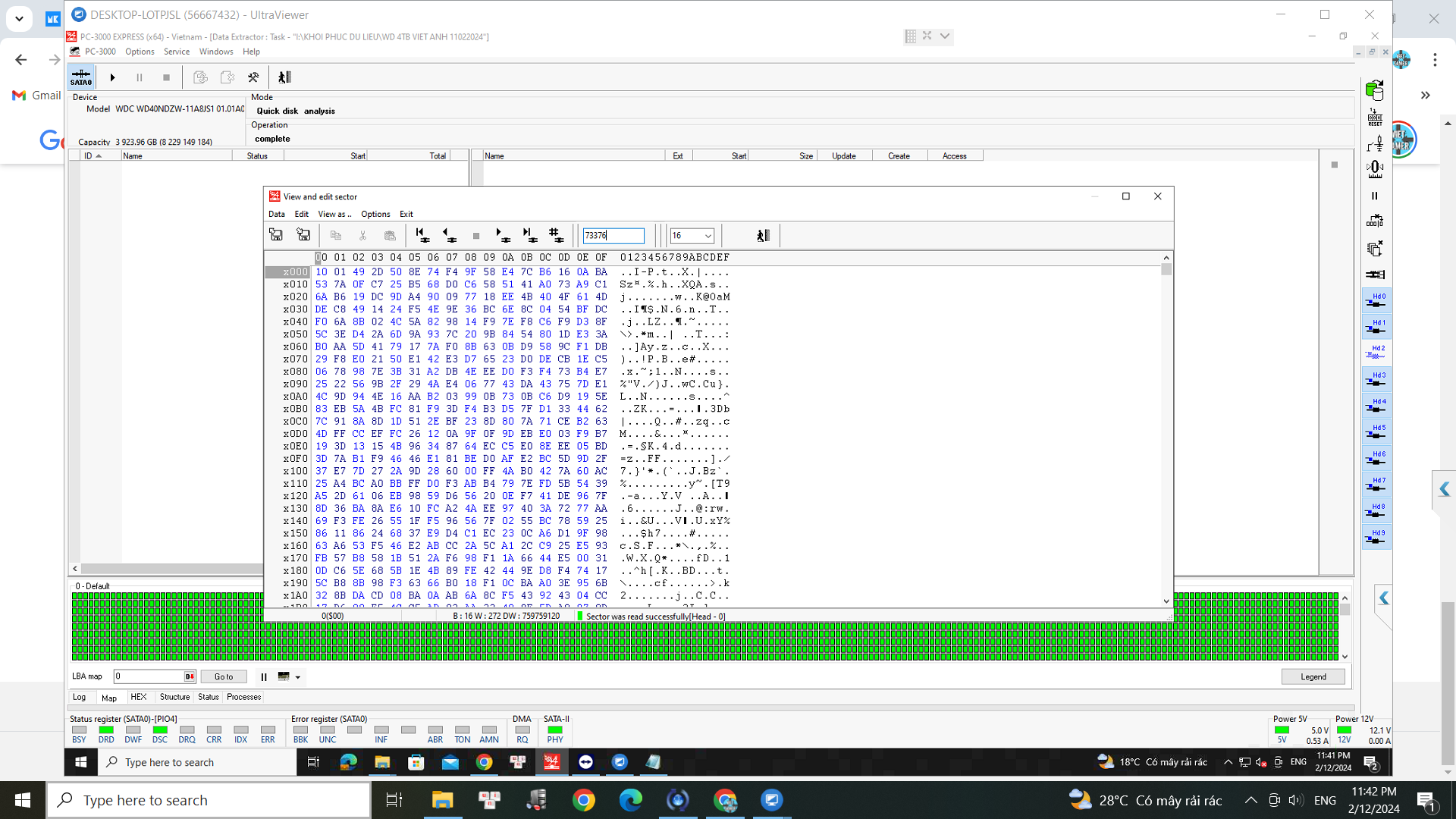

I got this 4TB WD drive in USB enclosure
Too many bad sectors made it almost impossible to read in USB mode
So i Soldered SATA cable instead
- Unlock ROM and WROTE it back to original PCB through POGO PINS
- Drive Comes Fully Ready

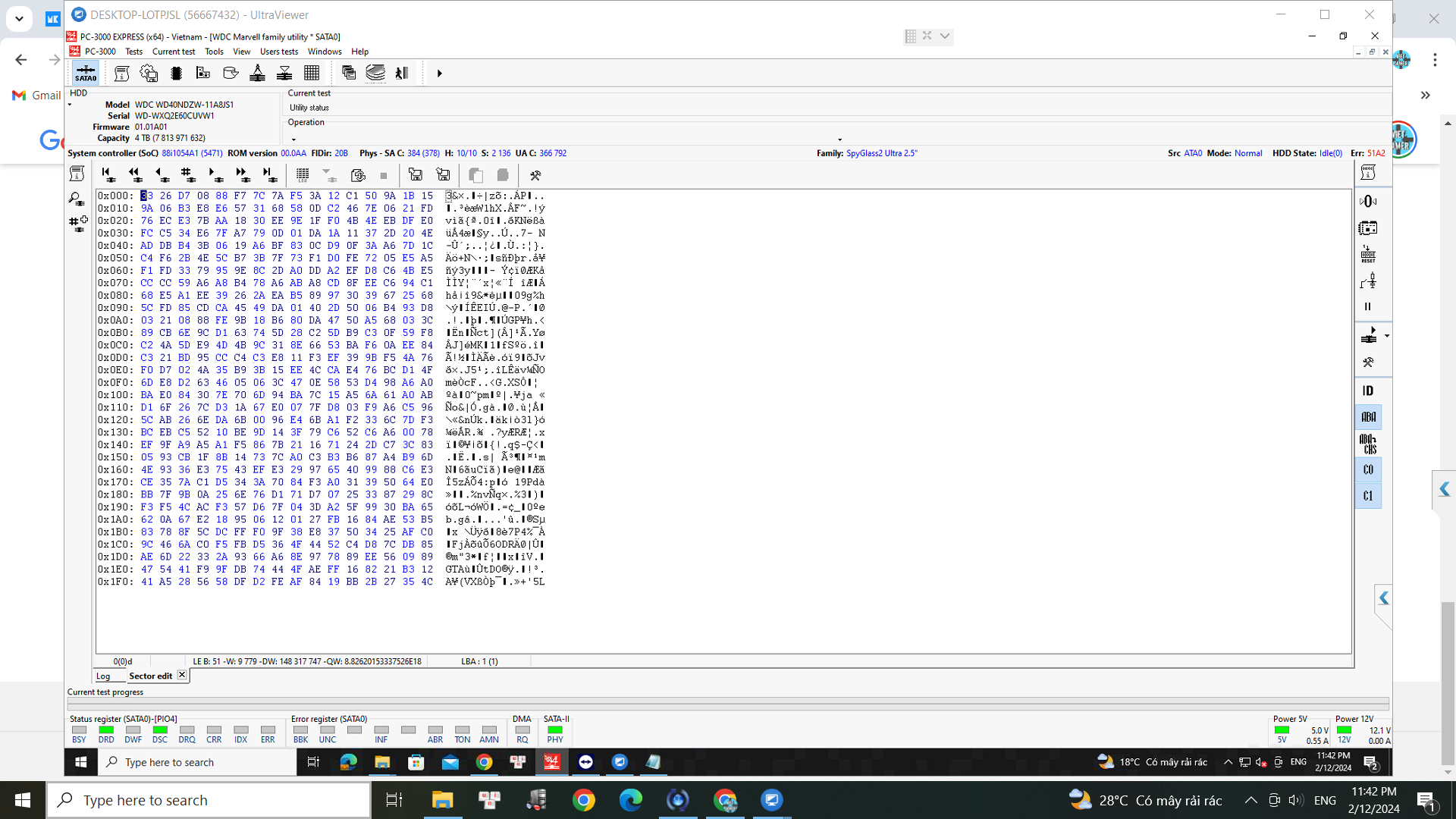

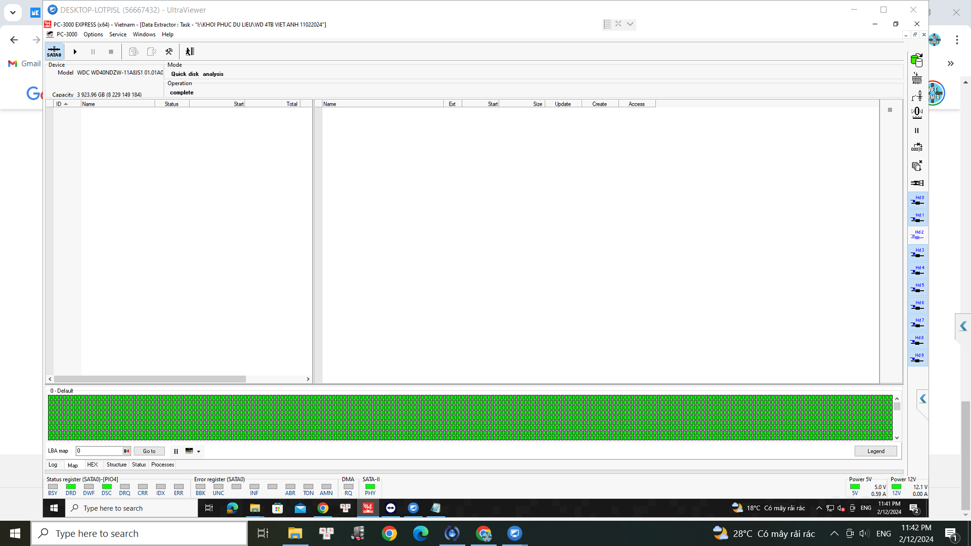

- However after Decrypting the data table wont show up in DE
- Through Sector Edit. Sectors before decryption was readable. After decryption is not readable

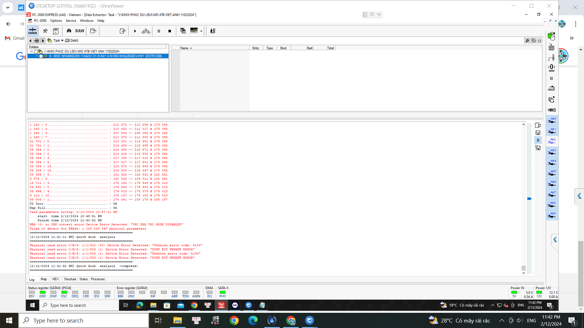

- Got error messages when Building Heads map
Can anyone help me with this???

HERE IS CODE WHEN BUILDING HEADS MAP
Reading method.......................... : VSC command (T2 Data read)
T2 read................................. : Ok
Zone type............................... : Type 2
Zones................................... : 5 865
SMR zone read........................... : Ok
SMR zone indexing....................... : Ok
26 329 / 9.............................. : 193 030 -- 195 885 # 173 119
26 329 / 10............................. : 196 121 -- 196 983 # 173 119
2 296 / 4............................... : 197 227 -- 203 049 # 173 119
2 296 / 12.............................. : 203 050 -- 208 570 # 173 119
38 749 / 5.............................. : 208 571 -- 214 399 # 173 119
41 036 / 4.............................. : 206 153 -- 206 860 # 176 129
58 306 / 4.............................. : 206 861 -- 207 364 # 176 129
58 306 / 7.............................. : 207 365 -- 207 857 # 176 129
......................STILL MORE AFTER THIS................
MBA <0> to CHS convert error Device Error Detected: "VSC ERR VSC MODE DISABLED"
