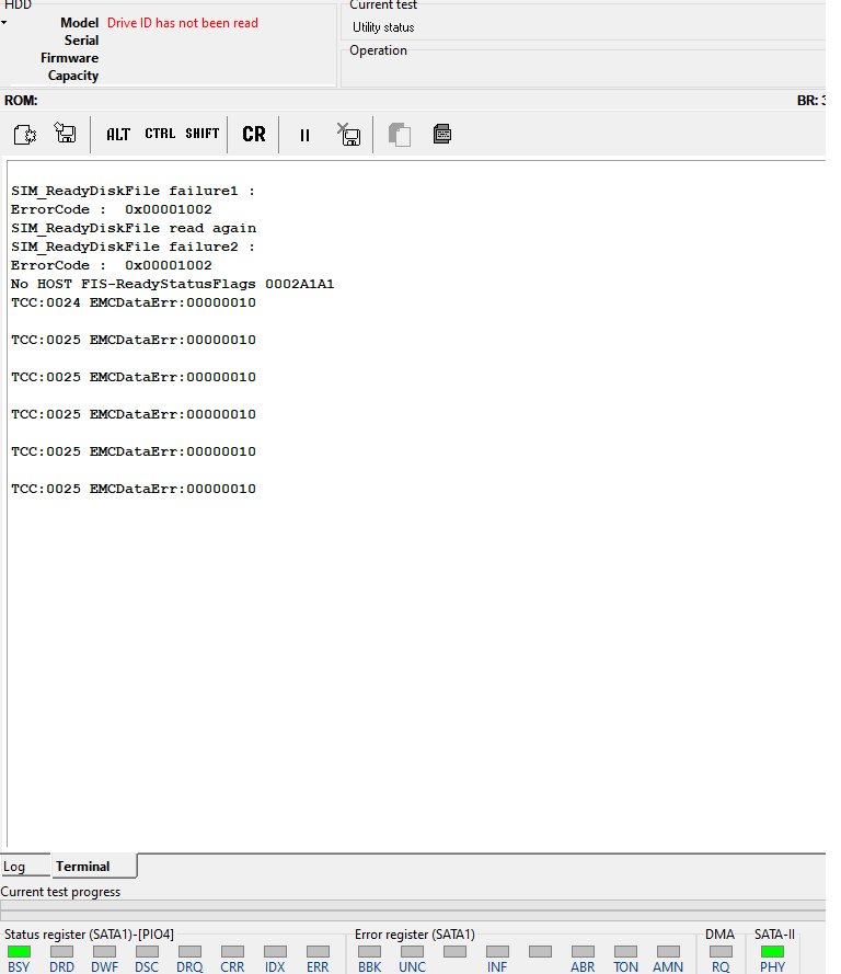

Hi guys,
Have a ST8000DM004 here. Spins up and keeps going and no funny sounds. No ID and stays busy. The blog for "No HOST FIS-ReadyStatusFlags" is only for non SMR drives so didn't want to go that route. Have attached the screen shot. can you please advise?
