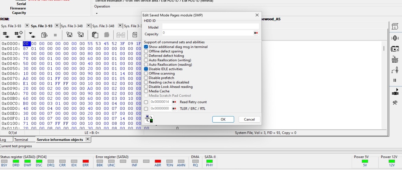

I have this one TB seagate ST1000LM035 PN: 1RK172-070, FW: LVM1, SITE: WU , ID is not detected, but spinning normally and i could access the terminal, i backed up necessary modules, but when i try to edit SMP , and save it gives error in red "un supported by firmware", it is running smoothly, but no id, i could backup all modules from head 01, module 28_00 is not read, but 28_01, could read, when i try to write it to 00, also gives me error "unsupported by firmware", also 348_00.rpm could not be read, but 348_01 could be read. The disk is not writing in indirect or direct method.
can any one tell me how to deal with this issue
thank you
I used "Solve the Device Fault State (DWF) Issue" it reads id and sn but zero capacity , also could not write back to SA any module

You can disable reallocations and background processes via terminal.
If the copy you got from 28 and 348 you can upload them to RAM instead, to write back can be dangerous.
There is a dedicated section in the F3 manual with detailed instructions. Think it is also covered in one of the update clips on Acelabs Youtube channel.
