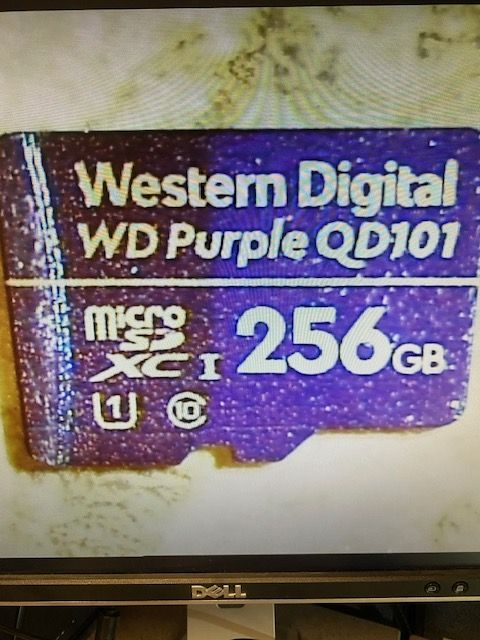

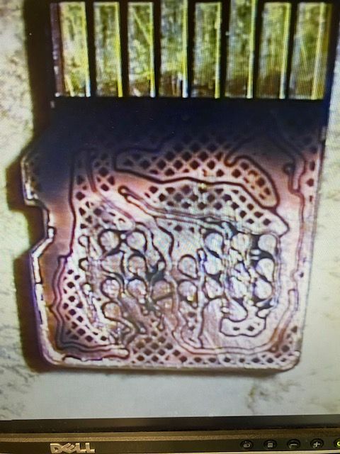

Hello, I am not sure if this sd card is supported or not. I am not sure which pinout supports it.
Its a Western Digial 256 GB
Any help is appreciated

Hello. Western Digital mSD = Sandisk mSD. So feel free to use Type 1 scheme:
http://www.pc3000flash.com/solbase/mono ... 4&lang=eng

Guys, this card use LDPC, do not waste time on it ;) MicroSD v164 from my DB https://odzyskiwanie-danych.com.pl/monolith-database/
