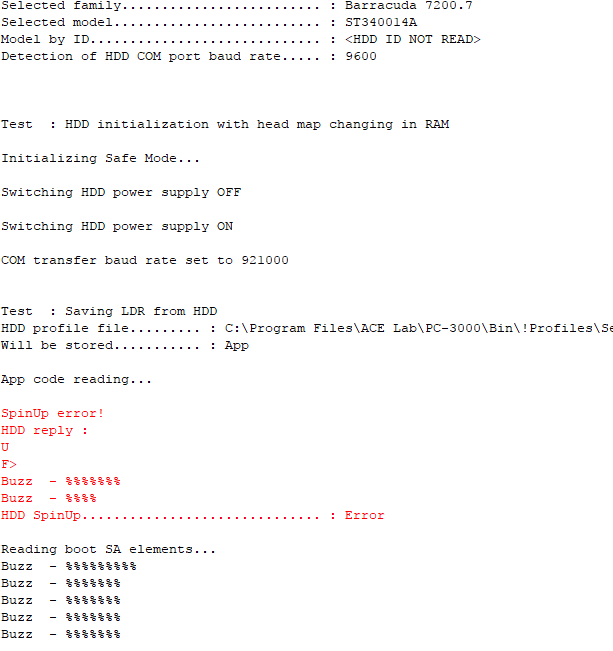

Hi guys. I have a problem. disk on bsy. I try create loader from this drive but it did not work. when I power hdd spin work but stops after a while.
SEAGATE BARACUDA 7200.7
40 GB
MODEL: ST340014A
FIRMWARE:3.06
Terminal output
F>r
Code - FE Track 0E370.0.000 Sns 0D5
F>;
Age=00 Type=00 MxCyl=0000E386 MxHd=00 MxSct=280 BSz=0800 TCode=0000

Good to know a case story, what was with it before..
It has a problems with spin up.
Do you hear any abnormal sounds?
Firstly, check the PCB condition, try to clear heads contact pads.
Then think about internal investigation of the heads and surface condition.
