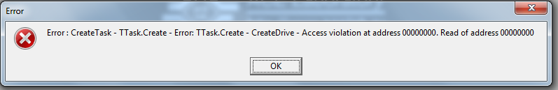

I hope all of you are good , I have a query regarding to Pc 3000 Extracter
When I create New Task Then a Dialogue Box Appear that shows Error
Please find Attachment
Kindly help me out

Never seen that error - I would reinstall PC3000 or check setting for "Working folder" in DE

Thanks dear but still problem

What is your working folder as digitalsupport mentioned, we usually put it in dirve D, if yours in drive c it may need Administrator privilege to get access !
