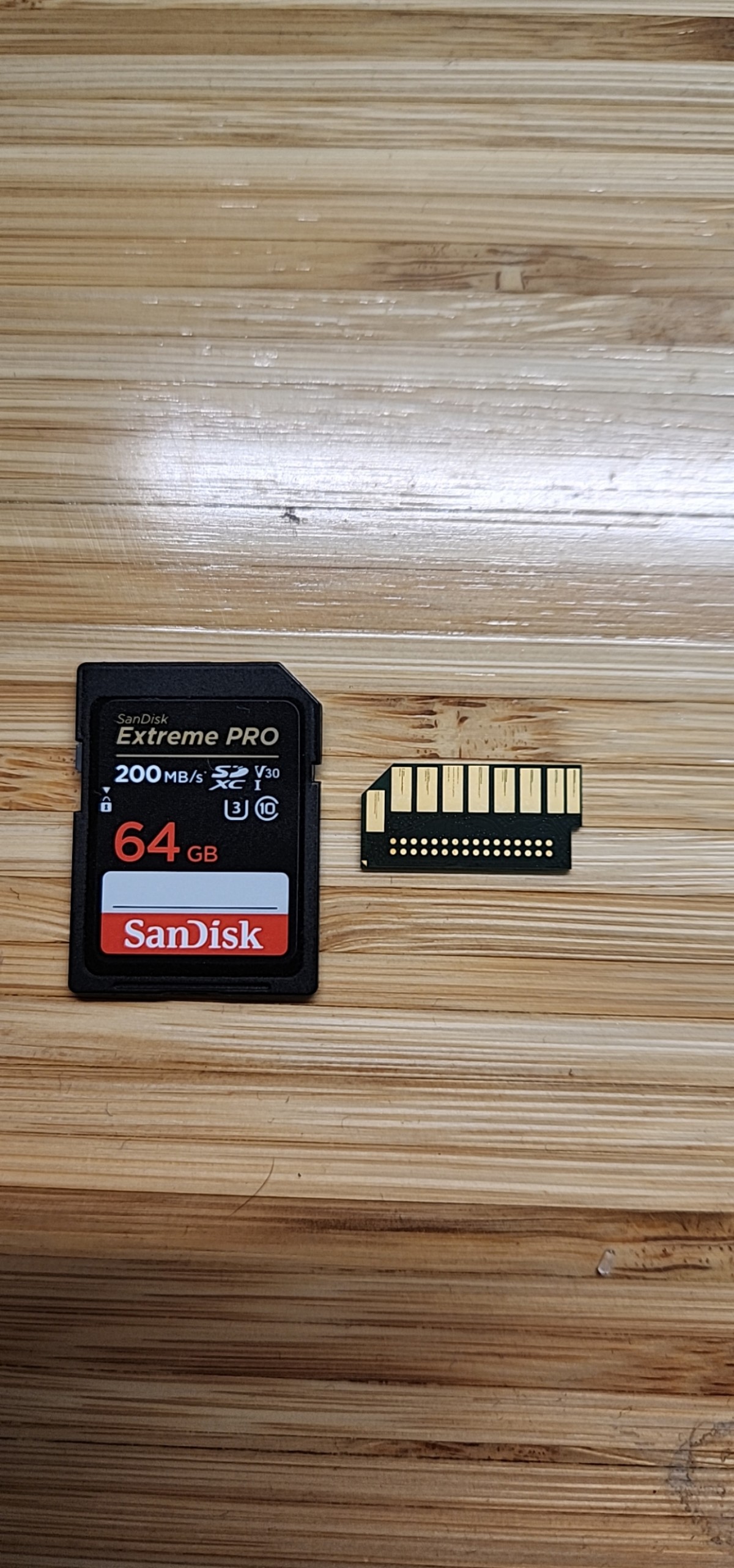

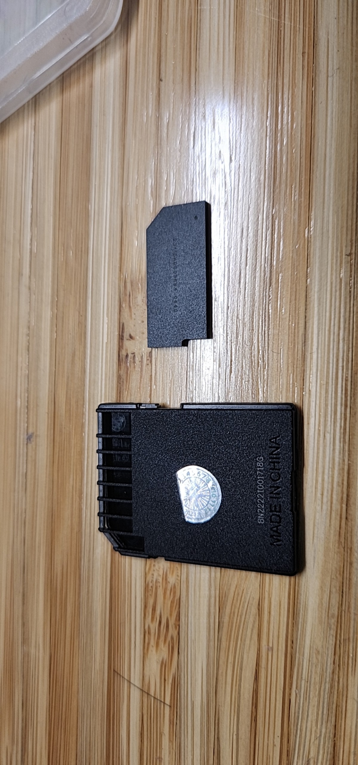

Hi everyone,
I got an SD card formatted with a Fuji Camera, trying to get the data back
Can you guys help me out. If can, tell the specifics of the process.
I just started out, still learning stuff
1st i want to find the Pin Description? is this SDHC Type 4
Thanks for helping me out! :thumbup:
arvika
Posts: 84
Joined: 14.10.09
Re: Help me find PIN DESCRIPTION
Postby arvika » 11.10.22, 10:59
Compare your model with: http://odzyskiwanie-danych.com.pl/image ... arvika.jpg
If same, do not waste time on this case. It use LDPC correction algorithm, which is no craced so far.
Postby gameboybin » 14.10.22, 18:16
arvika wrote:Source of the post Compare your model with: http://odzyskiwanie-danych.com.pl/image ... arvika.jpg
Will it be able to be Recovered in the near future???
