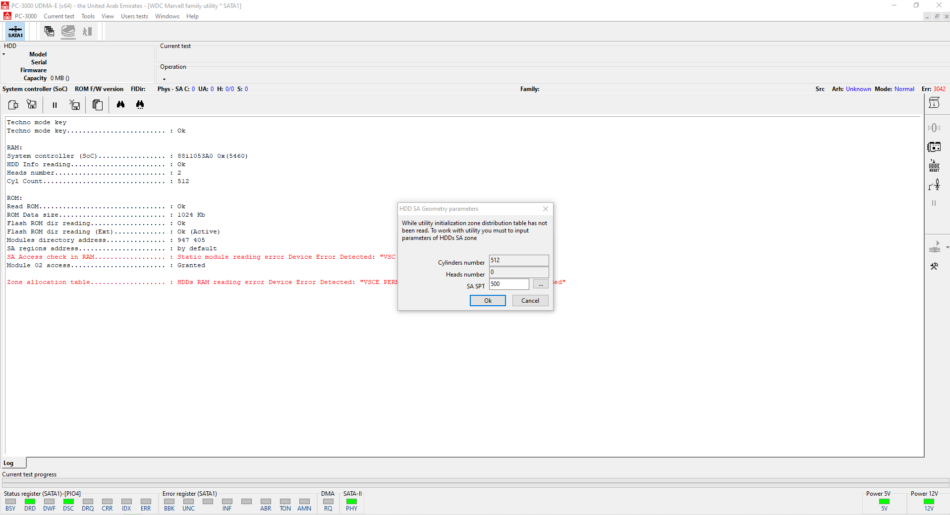

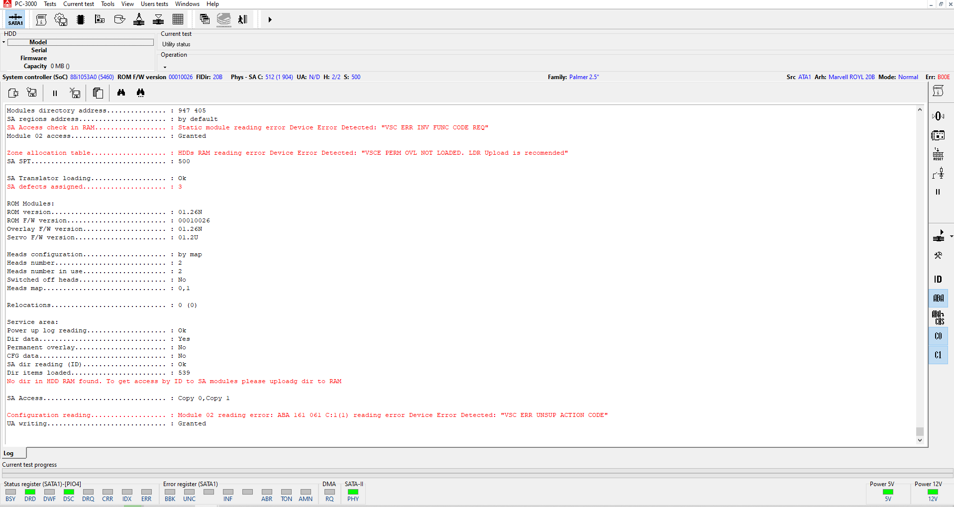

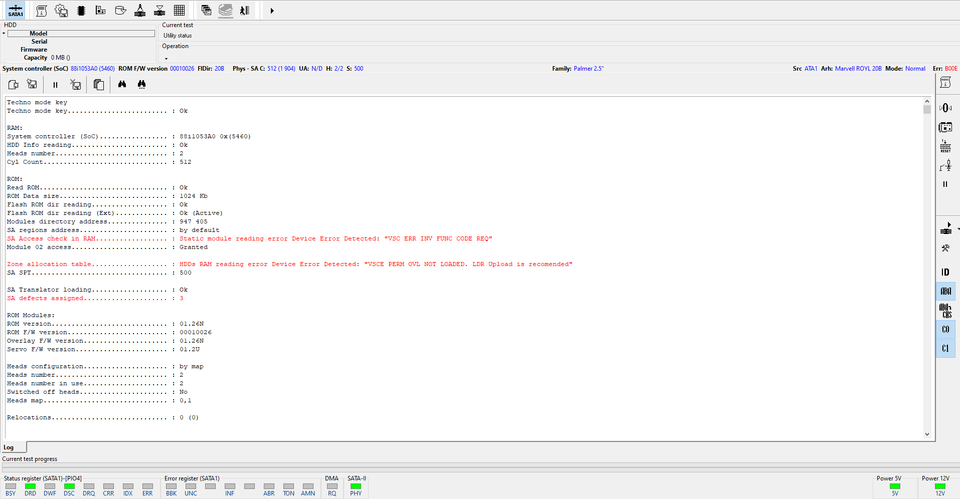

hi
I have a hard drive
have WDC WD10SMZW-11Y0TS0 Palmer Family
I unlocked its rom (SED locked)
But after unlocking, it does not read the ROM completely
And the size and model of the hard drive is not specified
Techno mode key
RAM:
System controller (SoC)................. : 88i1053A0 0x(5460)
Heads number............................ : 2
Cyl Count............................... : 512
ROM:
ROM Data size........................... : 1024 Kb
Modules directory address............... : 947 405
SA Access check in RAM.................. : Static module reading error Device Error Detected: "VSC ERR INV FUNC CODE REQ"
Zone allocation table................... : HDDs RAM reading error Device Error Detected: "VSCE PERM OVL NOT LOADED. LDR Upload is recomended"
SA SPT.................................. : 500
SA defects assigned..................... : 3
ROM Modules:
ROM version............................. : 01.26N
ROM F/W version......................... : 00010026
Overlay F/W version..................... : 01.26N
Servo F/W version....................... : 01.2U
Heads number in use..................... : 2
Heads map............................... : 0,1
Service area:
Dir data................................ : Yes
Permanent overlay....................... : No
CFG data................................ : No
Dir items loaded........................ : 539
No dir in HDD RAM found. To get access by ID to SA modules please uploadg dir to RAM
Configuration reading................... : Module 02 reading error: ABA 161 061 C:1(1) reading error Device Error Detected: "VSC ERR UNSUP ACTION CODE"
UA writing.............................. : Granted
Screenshot (21).PNG (10.99 KiB) Viewed 10327 times
Screenshot (22).PNG (11.36 KiB) Viewed 10327 times
Screenshot (23).PNG (12.12 KiB) Viewed 10327 times
Can you help me?

The ROM is being read correctly. You need to use a loader from a donor drive with the same ROM FW.

First get the loader. Then upload the dir and overlays via the RAM button in the utility.

I tried, but after uploading dir
It gives this error and does not upload
Statc Mdl writing error Device Error Detected: "VSC ERR INV FUNC CODE REQ"
or

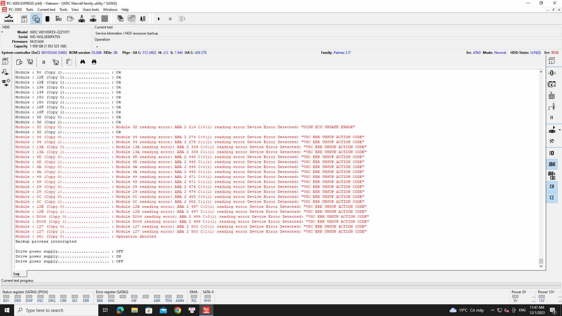

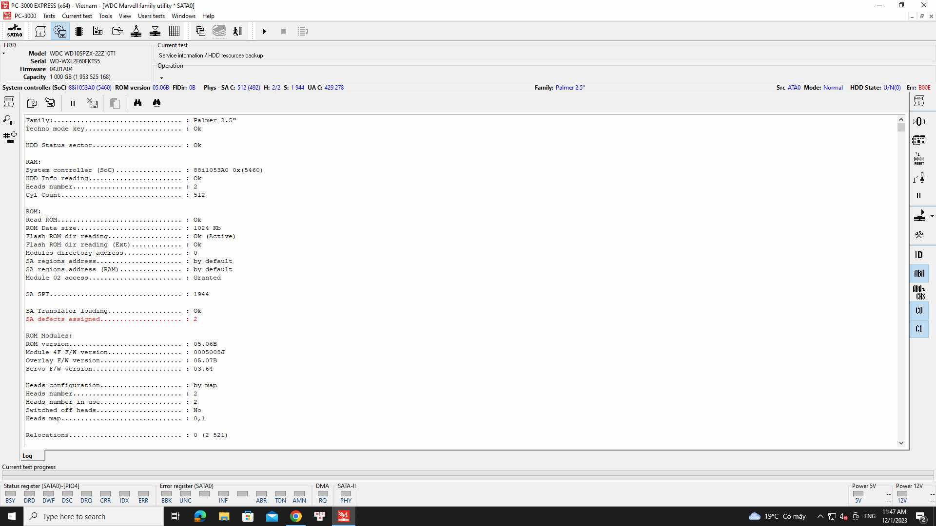

Postby gameboybin » 01.12.23, 05:54
Hi everyone. I am having same issue
Mine has bad heads, was clicking before. I changed those heads. The drive becomes ready and showing full ID
Right as soon as i clicked resources backup the drive read through some modules and died showing DISK ECU UNSAFE ERROR and VSC ERR UNSUP ACTION CODE
I think the PCB might be the HDD killer. The drive wont spin no more, Having 0.17V on power. So platters wont spin no more
