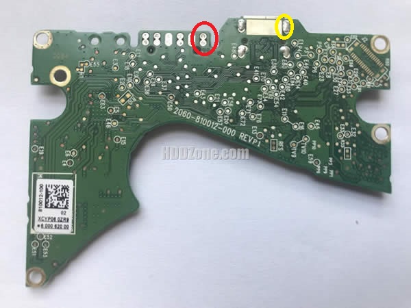

I have 2060 810012 C type PCB which C port has a problem so drive powering up issue , now i need to solder SATA power cables to the 2060 810012 C type PCB . Anyone can help me to locate the GND and power pins location in PCB ?

Always best to test with a MM to make sure.
Power red, ground yellow.

You can wire up the SATA connections and then power the drive up by the USB connector.

Did you use a Multimeter to test the points I marked?
Can you send a picture of exactly what you have done so far.
