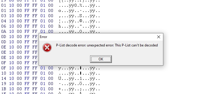

Hello guy's!
I have corrupted USB TOSHIBA MQ04UBD200.
USB and SATA pcb both tested same issue. DE cannot support translator regenerate USB pcb version.

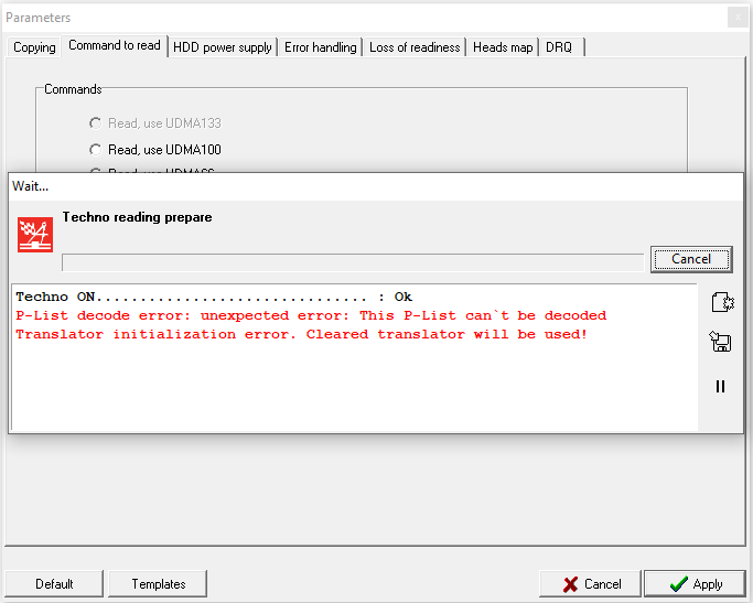

Using DE (s-ata) regenerate translator showing: (same with toshiba utility)
P-List decode error: unexpected error: This P-List can`t be decoded
Translator initialization error. Cleared translator will be used!
DE (s-ata) recovering big files cracking. Image and video files 98% recovered unsuccessful.
Any solution ?

Techno ON............................... : Ok
Data access mode setting................ : UDMA 100
plist cant decode small.png (17.78 KiB) Viewed 9308 times

Re: TOSHIBA MQ04UBD200 P-list decode problem
Postby Filipp_TS » 13.01.21, 13:29
This message means that on current drive Plist parsing is unsupported.
PC-3000 'don't know' how to interpretate defect records in P-list.
It doesn't mean that Plist is damaged (but it could be), it means that content inside Plist can't be parsed because of unknown structure.
As result Virtual translator won't use information from Plist.
donor toshiba plist.jpg (5.58 KiB) Viewed 9280 times
