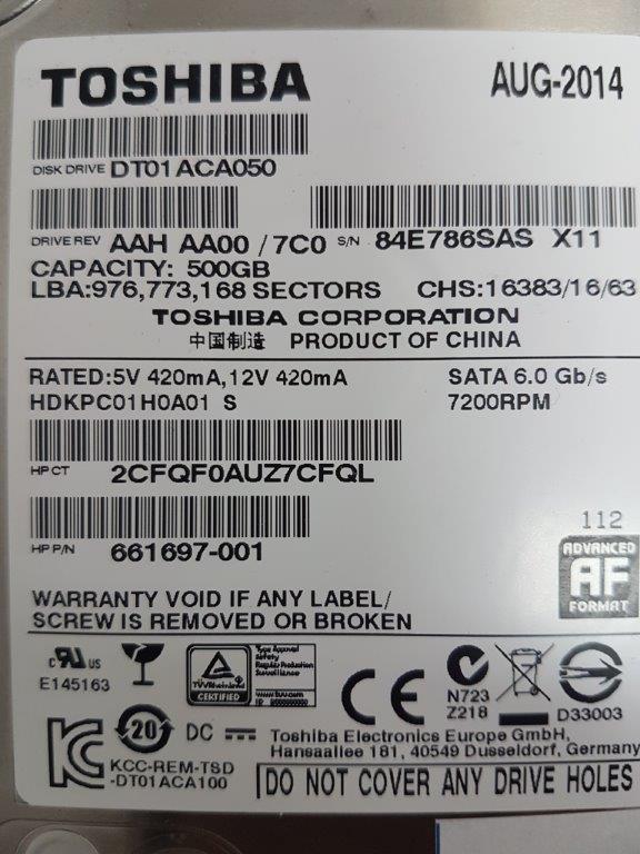

with this HDD toshiba I use Hitachi-IBM-Arm utility = 7210DLE6
But what do you use to identify head compatibility?
If he can help, a photo from hdd is attached. :roll:

stevan.vukovic, Hello!
Actually these drives are not very sensitive for heads swap. I advise you to use same model drive AAH AA00 revison with close production date.
Also pay attention that this model can have 0 or 1 head map. Don't make a mistake :wink:
