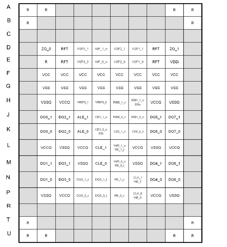

Need to read a set of vbga-100 chips. Is there a pinout scheme to use soldering by Circuit Board adapter, or we need to buy its adapter?

You can try to solder it via Circuit Board, but the whole process will be much more complex than a common reading via adapter.
But if you have a lot of free time - it's up to you :)
P.S. All ONFI pinouts you can find in ONFI.ORG
