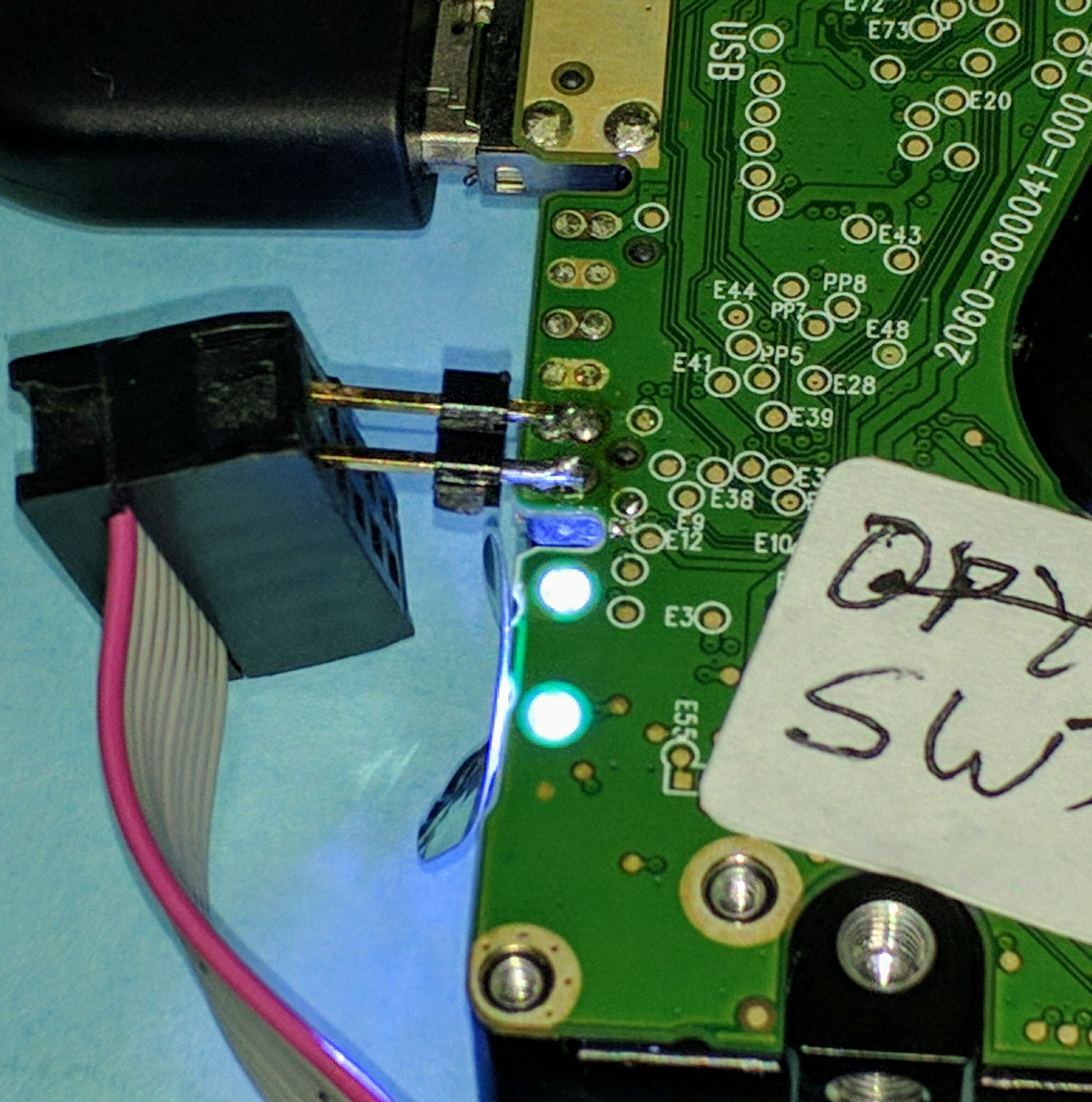

better way to connect terminal port on 800041 board
this is easier just add 2 pins to the board and connect...
you dont need ground, aces adapter doesnt use ground.
the toshiba adapter 1 pin offset method has no ground.
the maxtor calypso adapter to the 3.5 wd only uses 2 wires.

anyone can show how to make USB to SATA connection of WD 4 tb model:WD40NMZW-11GX6S1 AND PCB no is : 2060-800041-003 REV P1 .The pics of the PCB given in the same post. i am not able to find out the 4 PF which i need to remove . I can see the E71,E72,E73 and E75. But in the inside portion there is no reference marking of PF.
Any one have idea plz lead me.

betty wrote:Source of the post i am not able to find out the 4 PF which i need to remove

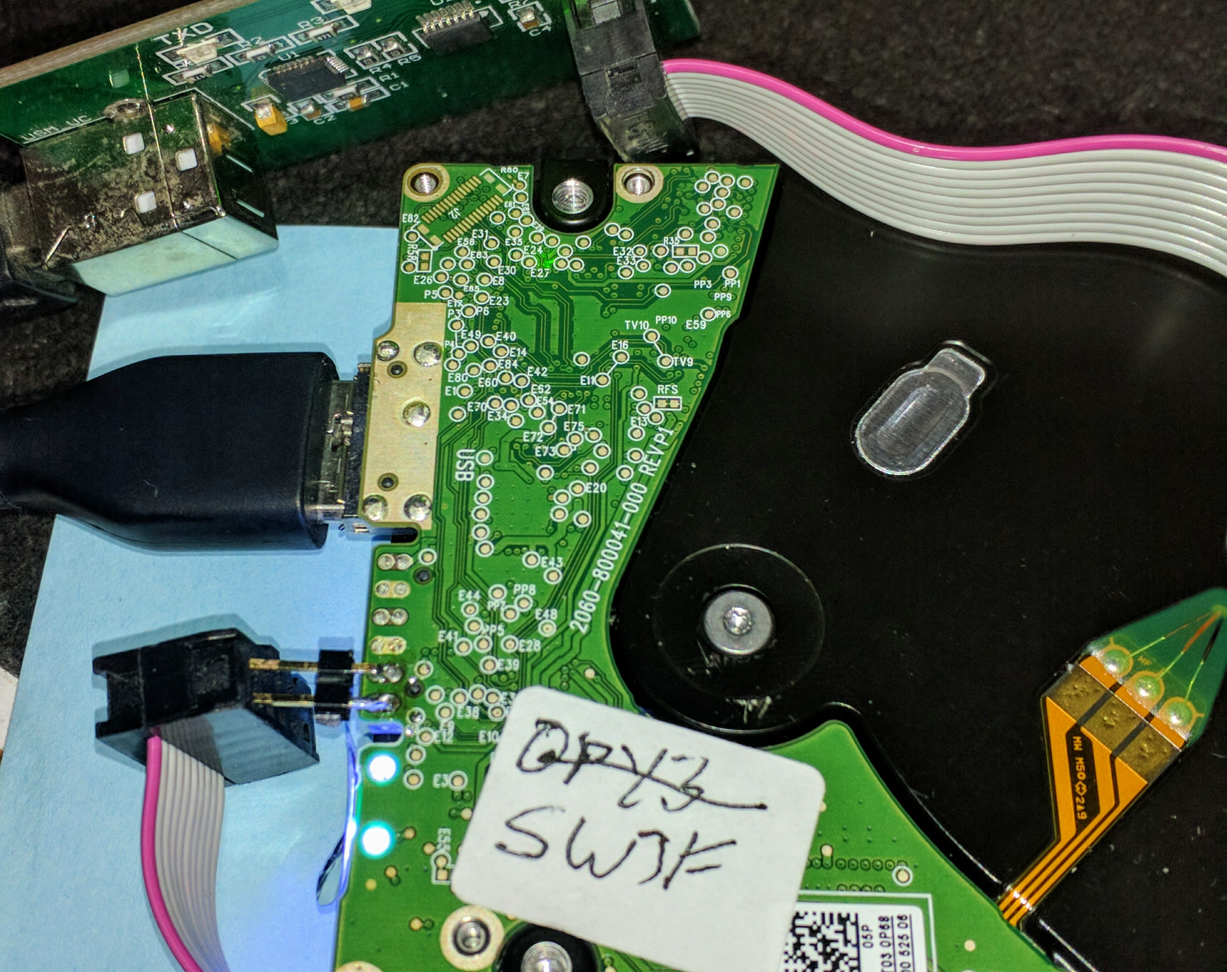

Contrary to my previous position....
I have found difficulties reading the roms with just 2 pins.
I used alligator clips and grounded the board to the computers chassis
And then I could read without issues.
So - yes you do want the ground.
Maybe before it was grounded through the usb power, not sure but use the ground.
