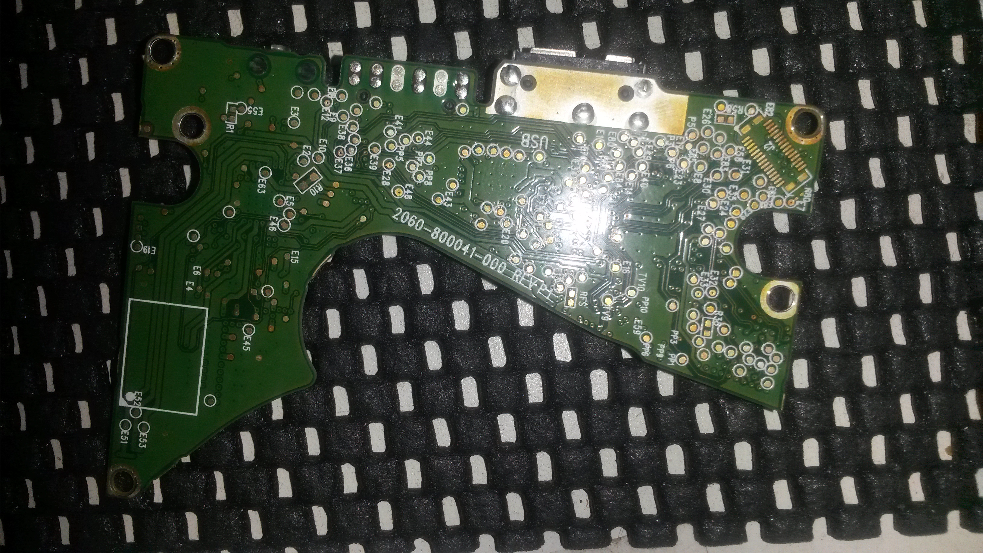

Where is it on the new PCB's place to shorting channel in WD30NMVW???
Re: Is the WD30NMVW-11C3NS2 supported?
Postby digitalsupport » 09.06.17, 15:49
Sorry but what do you want to short?
