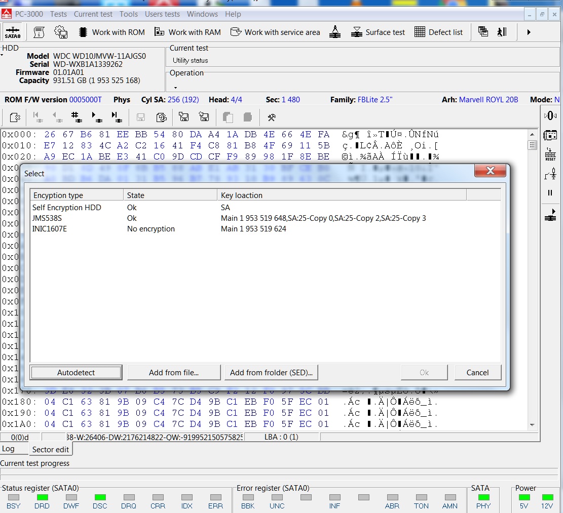

After a little more farting around and ignoring the two place suggesting a re-power of the drive, I now get 3 (!) "Encryption Types" (see attached)
The Main/Top selection applied changes the data, but still looks encrypted.
But now, when I select the second "JM..." choice, It looks de-crypted.
I followed the rest of the instructions using DE-COPY with "Decrypt" option in Task Params, turned off Head 1 - success!

Hello Platterpuss, it is not necessary to repower the drive when it starts with full ID and does not show SED issue at the beginning.
If you see SED in decryption tab, always choose Self Encrypting to decrypt the data.

Platterpuss wrote:Source of the post After a little more farting around and ignoring the two place suggesting a re-power of the drive, I now get 3 (!) "Encryption Types" (see attached)

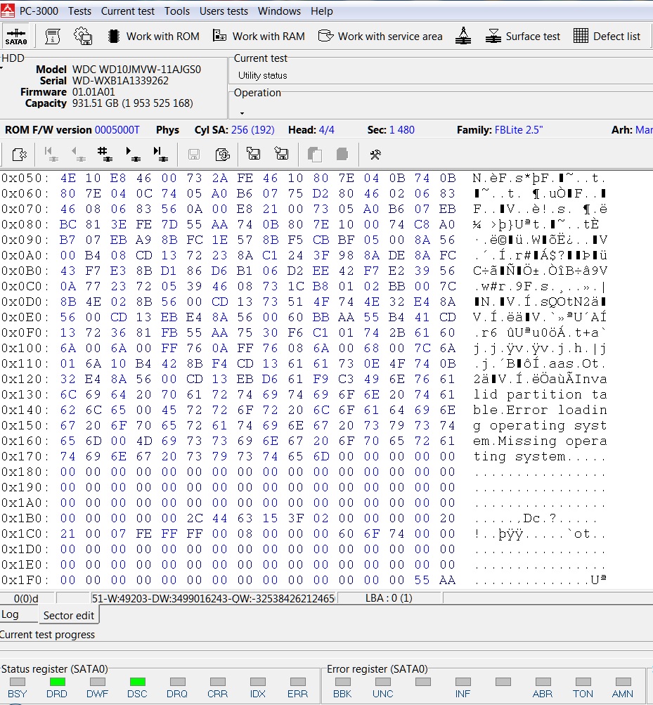

I already know how to decrypt using PC3K, I'm more interested in the differences between the encrypted and decrypted hex.

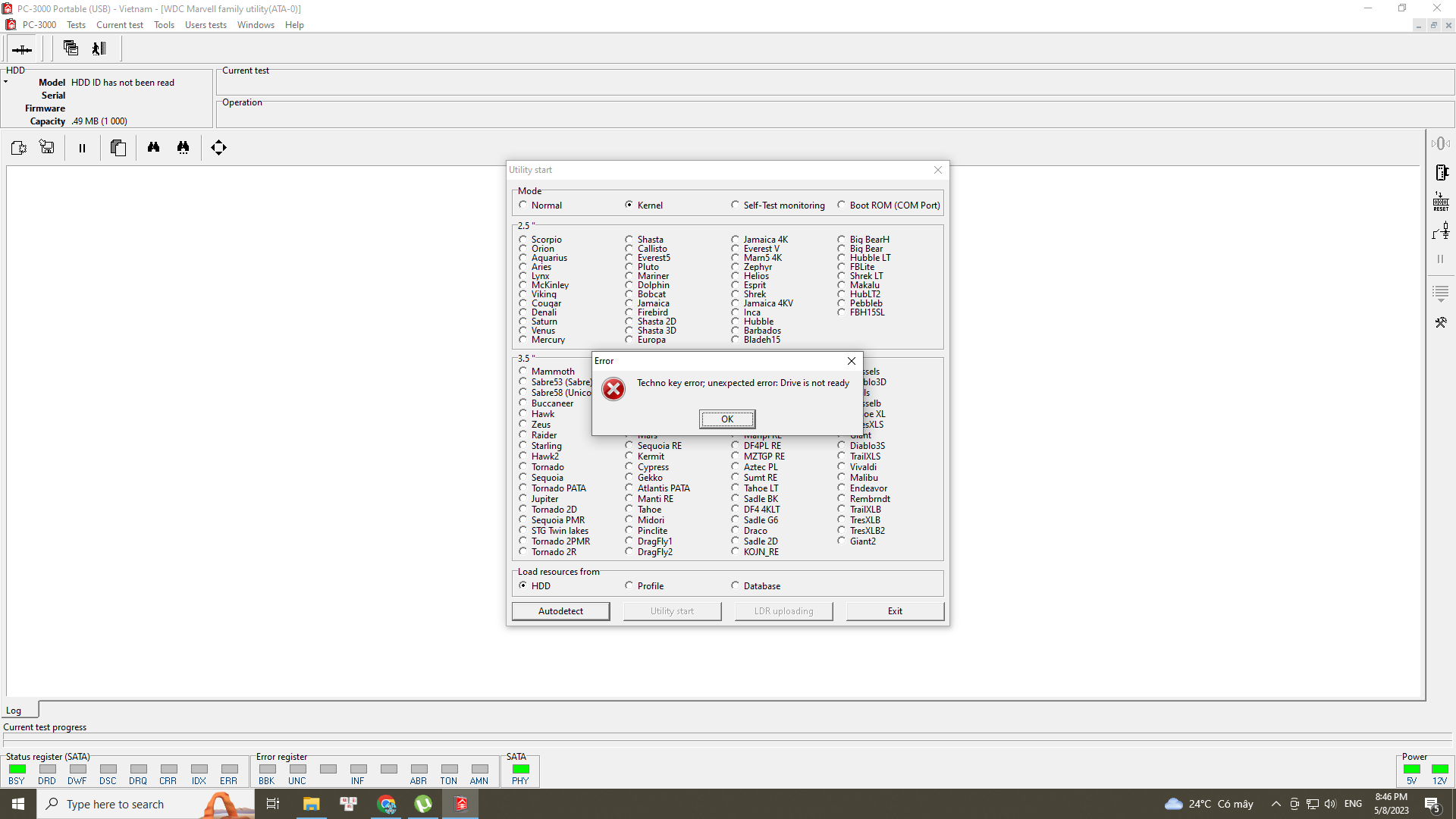

I got a 1.5TB WD Elements WD15NMVW-11EDZS6
I Got this error upon Detecting in 1st Step Kernel Mode. The Drive then spins down
Can anybody help!
Thanks!

gameboybin wrote:Sorry for digging this up
Can anybody help!
Thanks!
Bsy is light. you can't access anything on this state.
Try short pin read or somthing to ready light and unlock SEC.
