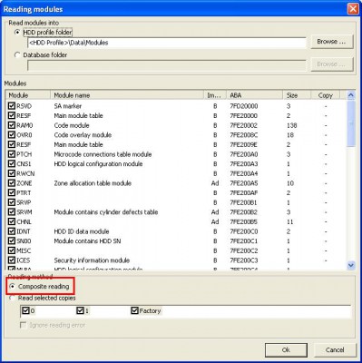

Run reading SA modules using option "Composite reading"
reading modules.JPG (71.13 KiB) Viewed 17439 times
Paste here log.

Re: HTS723232L NOT DETECT !!
Posted: 24.05.12, 16:19
by AJ2008
NVRAM adjustment will not help.
You need somehow to get copy of all crucial modules. If composite does not work well then maybe there is possibility to read each module with 'Ignore reading error' and see if there is possibility to manually rebuild it.
How many heads does the HDD have? If has 4 heads is possible to switch SA surface as I assume the SA surface(s) here are not so healthy.
