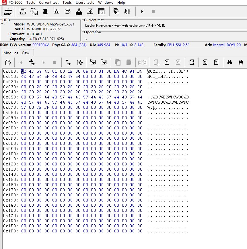

This is a good hard drive

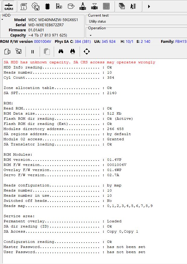

Prompt when loading SA HDD has unknown capacity. SA CHS access may operates wrongly

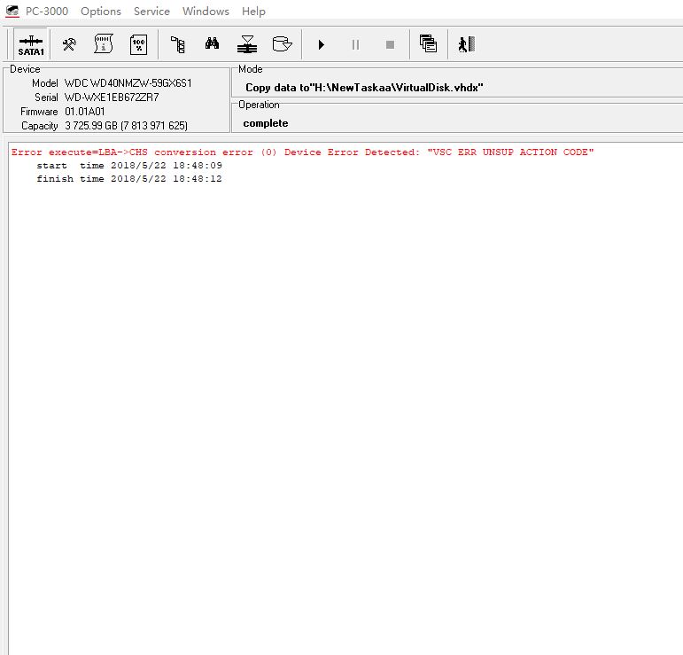

Create a head bitmap in Data Extractor, tips Error execute=LBA->CHS conversion error (0) Device Error Detected: "VSC ERR UNSUP ACTION CODE"
Log.log
(61.5 KiB) Downloaded 702 times

huangmiaofang, it's a new SpyGlass family and if it starts without SED error, it's partially supported in PC-3000.
